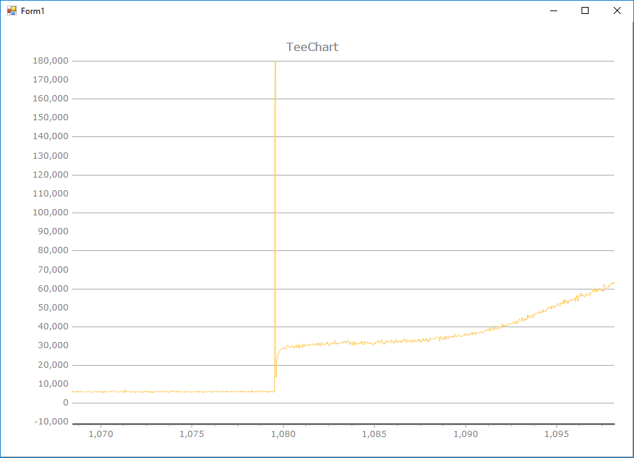

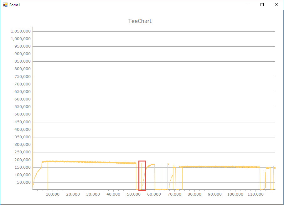

I tested this function using one of our actual data sets containing 100000+ points in a single series. Here is the full data set that has been downsampled to 5000 points. It appears to have been correctly downsampled and achieves our goals:

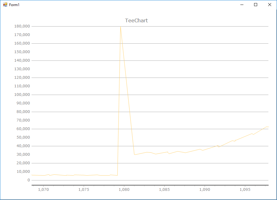

Here is the plot after zooming into the highlighted region above with downsampling enabled, and "CheckDataSource" called in the "Zoomed" event:
For comparison, here is the same region zoomed in to the original source data without downsampling:
If you compare the original vs downsampled plot of the zoomed region, you can see that a great deal of detail has been lost in the downsampled plot. It appears to me that CheckDataSource is not re-calculating the downsampled plot to match the displayed region, it is simply displaying a zoomed version of the original 5000-point downsampling of the full data set.

Hello Scott,
On closer examination the points plotted from DisplayedPointCount is not perfectly fixed according to total plotted points. There is a fixed tolerance that brings the display points down after a certain point. When tested on a 100,000 point series with a DisplayedPointCount at 1,000, the plotted function points held firm at that level until zooms went down to about 7,500 data points whereupon plotted downsampling points total begins to reduce. With this in mind, I would approach the problem in a different way perhaps; that when visible points are below a certain threshold[s], that you adjust the DisplayedPointCount accordingly or turn it off completely ( DisplayedPointCount = 0;).
private void tChart1_Zoomed(object sender, EventArgs e)
  if (tChart1.Axes.Bottom.Maximum - tChart1.Axes.Bottom.Minimum < 5000)
		downSampling1.DisplayedPointCount = 0;
		line2.CheckDataSource();
You may find the new down-sampling method, Douglas-Peucker, available with the next update, a better fit for your needs. The reduction algorithm is better tuned to the data.
