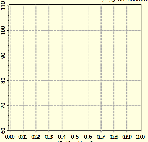

As we are going to use this revision, it has an small issue where the vertical lines and the labels are overlapping each other. Actually there are two teechart components exactly on top of each other. The overlap issue did not occur with initial revision of Teechart(September 28, 2010(Build 4.1.2010.09280)), however overlap issue started occurring with very next revision of teechart(November 30, 2010(Build 4.1.2010.11300)). Please see attached pic.
We suspect that issue may be related with the Visibility property of the Teechart.WPF.Styles.SeriesPointer.Pointer. Changing the visibility of this property also alters the vertical line's location. Was there any change between these two revisions related to this property Teechart.WPF.Styles.SeriesPointer.Pointer.visibility ?
Can you please guide/suggest us towards resolving this issue ? Any suggestion will be deeply appreciated.

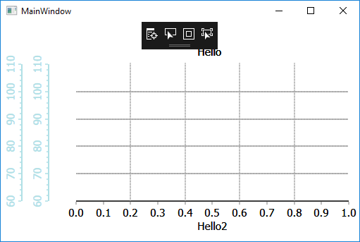

Hi Christopher,
Please find the attached verifiable demo project.
Compiling and running this project with reference of TeeChart.WPF.dll v.4.1.2010.9282 will not result in any issue.
However compiling and running this project with reference of TeeChart.WPF.dll v.4.1.2010.11302 or v4.1.2012.1311 or any other recent version will result in overlap issue.
As informed earlier, we have finalized to use v4.1.2012.1311.
We prefer the solution if it is achieved without modifying the source code of Teechart, i.e. better if we can bring back the original behavior by tweaking some of the existing properties of TeeChart.WPF.dll.
Thanks and Regards,
Thanks and Regards,

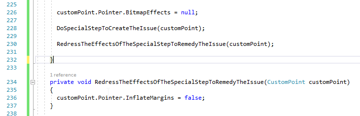

This issue can be resolved by a single line of code. Using the latest publically available version of TeeChart.WPF.dll I have added this line in a method:
adding in this line resolves the problem:
