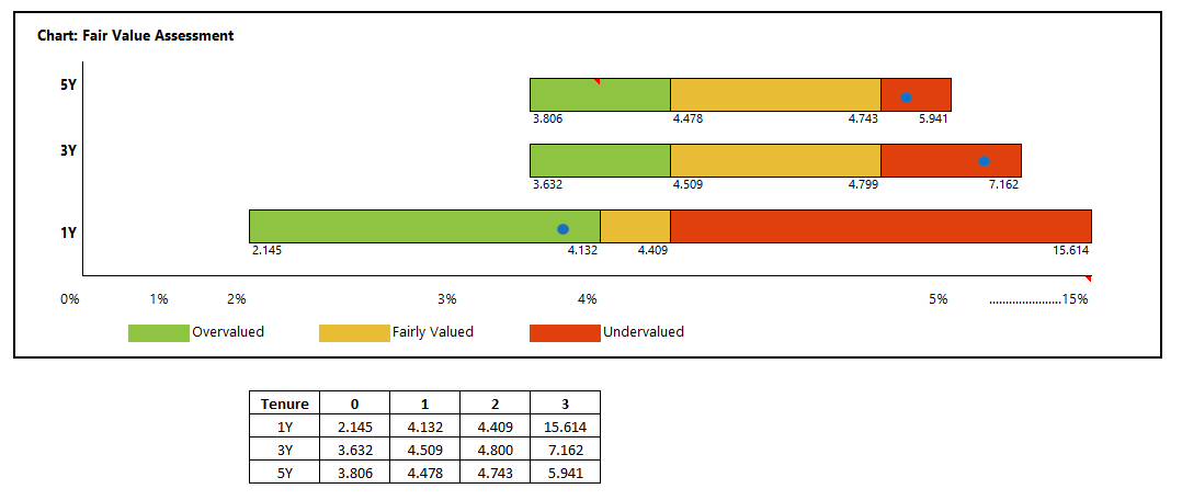

would like to know to can I set horizontal stacked bar chart as attached image.
i cant seems to get the stacked to work correctly.

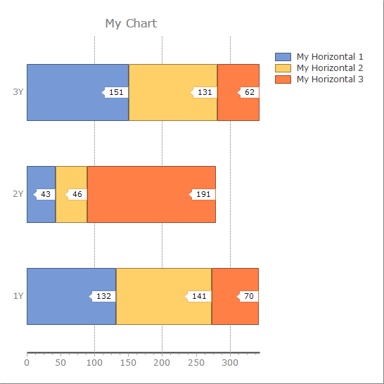

Well, some code to help you get started would be something like this:

which gives me:

Hi Christopher, thanks for the prompt reply. I managed to get the chart working.
But I having issue to set the chart to start at a specific value instead of 0.
Please refer to the attachment. Thanks.

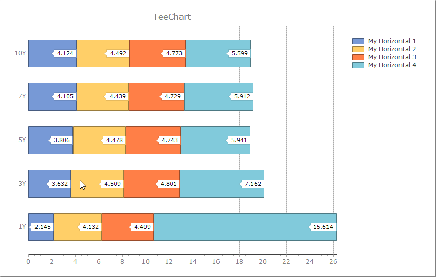

Okay, well, taking your data set I've been able to come up with the following code:

This gives me the following chart:
I would suggest this chart is correct - take the "1Y" row - this correctly reflects the sum of the 1Y data (26.3) and also reflects the first data point accurately on the bar (2.145). All the rows (1Y->10Y) are correct in this sense also. Would you agree that this chart is correct? If so, what chart would you like to see if it is not this one?

Hi Christopher, chart is incorrect. I would like to start the chart for 1Y at 2.145, 3Y at 3.3632 and 5Y at 3.806. please refer to the first image. Your sample is all starting from 0.

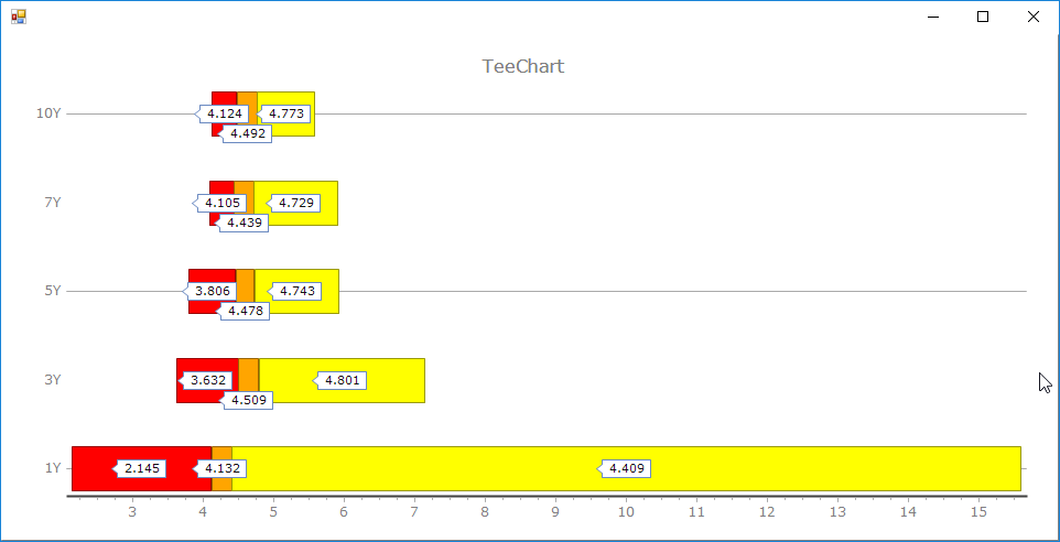

No problem - one way of drawing a horizontal range chart is to use the Gantt series, e.g.

bpamit
Posts: 6
Joined: Tue Apr 18, 2017 12:00 am
Re: Stacked Bar for Horizontal
Post by bpamit » Mon May 28, 2018 3:24 am
Hi Christopher, thanks for the codes. It works.
