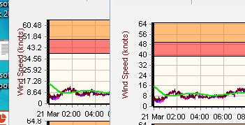

I've just upgraded from 2021.32.210430 to v2023.39 (231109) which seems to have a y-axis drawing difference.
As the image shows attached the left graph has for example 60.48 on the y-axis while on the previous version this would be 64, 56, 48 etc. Axis min = 0 and max = 65. It draws correctly with more space but if window is small its adding the dp's.
The AxisValueFormat is still the default graph_->LeftAxis->AxisValuesFormat = "###0.###";
I can reduce set ###0 which restricts it but wondering why the values produced are so different ?
Is this an issue with the new VCL TChart ?

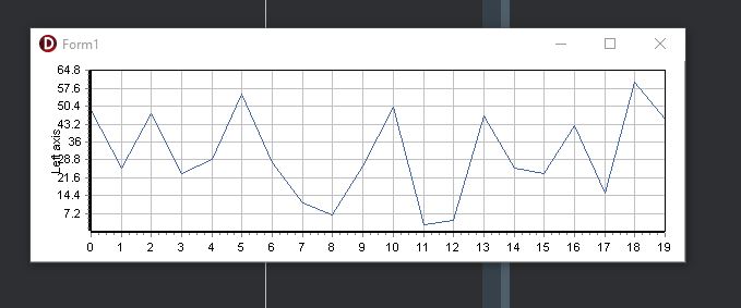

I've tried to reproduce the problem with this simple example code without success.
uses Chart, Series;
var Chart1: TChart;
var i: Integer;
  Chart1:=TChart.Create(Self);
  with Chart1 do
    Parent:=Self;
    Align:=alClient;
    Color:=clWhite;
    Gradient.Visible:=False;
    Walls.Back.Color:=clWhite;
    Legend.Hide;
    View3D:=False;
    with AddSeries(TLineSeries) do
      for i:=0 to 19 do
        Add(Random*65);
    Axes.Left.SetMinMax(0, 65);
    Axes.Left.Title.Text:='Left axis';
Do you have a simple example project we can run as-is to reproduce the problem here?

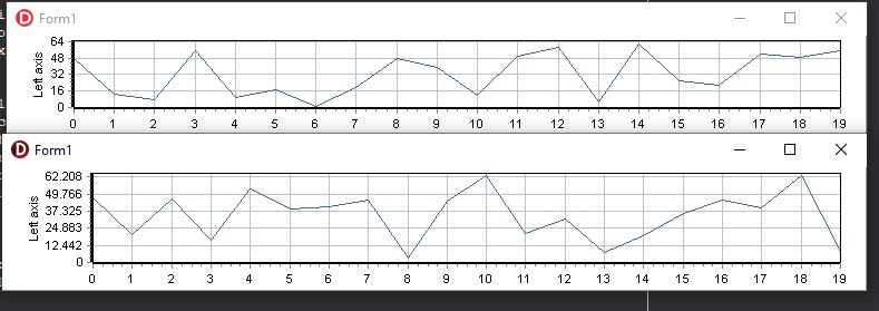

Only just had a chance to re-look at what the code we have is doing.
We also have the Axis.Left.Increment := 1 set in this case to try and reduce the number of y-axis labels rather than automatic.
With that setting in the past it still kept the y-axis labels clean rather than having the in the example 64.8, 57.6 etc
I've not tested that code on the older release yet but will try shortly

Ok I've tested with the two TChart version listed previously and as you can see with the same code the graphs look quite different.
Top one is v2021.x and bottom v2023.x

Ok I have a work around for the present time.
I check the ClientHeight and when its less than 200pixel I set Increment=0 (which is automatic by my testing) for graphs with max - min height < 200 units.
Greater than 200 height units I just set Increment=0

Indeed setting Increment to 1 was the key to reproduce the problem.
I've added it to the public tracker: #2690
