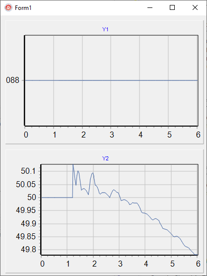

Post by » Wed Feb 08, 2023 8:30 am
Y1 series display error
Y2 series display ok
This is a bug?
Data in attachment.

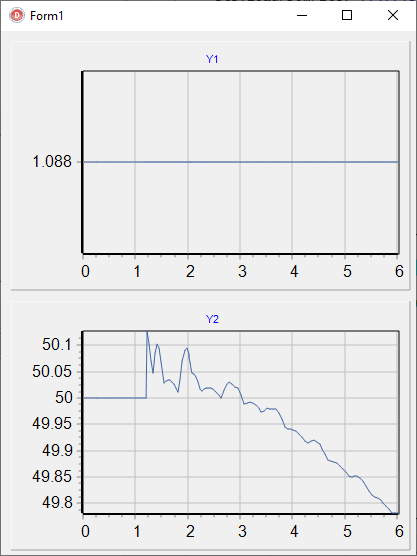

The example before the changes:
The example after the changes;
I believe you don't have TeeChart sources so I'm afraid you'll have to wait the next release. It should work as you expected.
