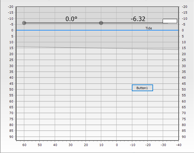

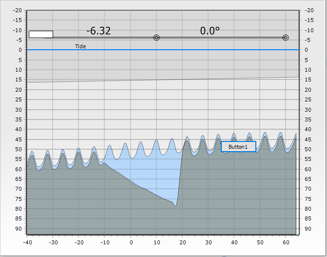

Can someone help me figure this one out? I have the chart (image 1) where if I invert it, the area series on the bottom disappear. The button on the form is a simple chart->BottomAxis->Inverted = ! chart->BottomAxis->Inverted. As you can see, everything inverts nicely except the area series. It just disappears.

Turns out this only happens when DrawStyle is set to Curves. It works OK if set to Segments.
