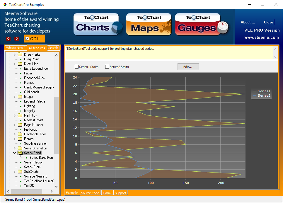

Check the Series Band Tool. I've just run the "All features\Welcome !\Tools\Series Band" example in the New Features demo, changed the series from Line series to HorizLine series and reassigned the second series for the tool:

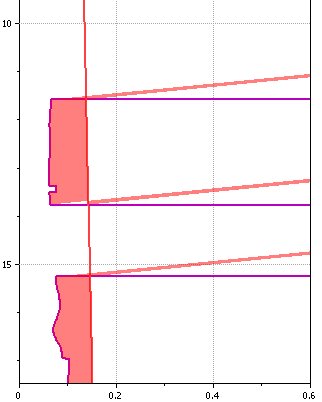

I tried that, had to change both line series to Horizontal type however the result is not good.
Regards
