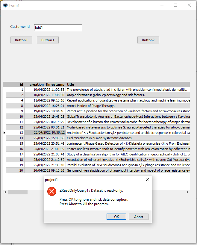

I have a gird with ReadOnly set to true. While I tried to copy data from one of the cells I accidently pressed ctrl+v (paste) and got the following error:
"Dataset is read-only"
That should never happen, if the grid is in ReadOnly mode it should block any attempts to change the content from user interactions.

I've tried with the example here and got a 'EDatabaseError' exception with the message:
Dbf1 : Operation not allowed, dataset "Dbf1" is not in an edit or insert state.
Not exactly the same error you reported, but enough to add it to bugzilla (#2524).
