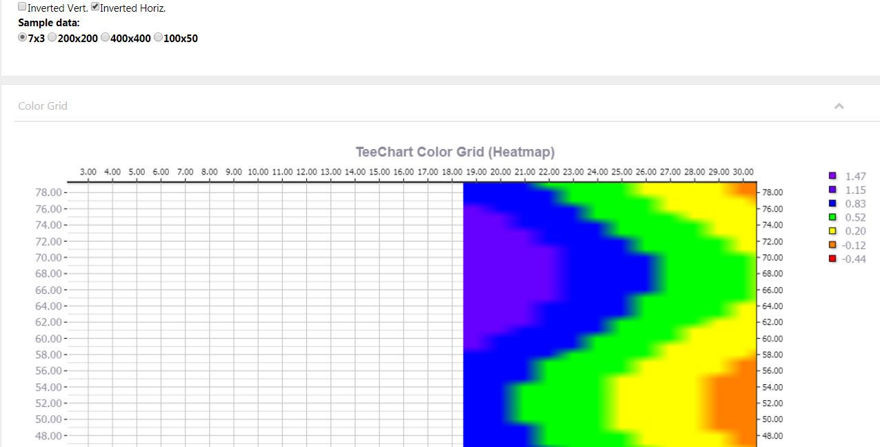

In Steema chart Color Grid, if we do chart invert horizontally and zoom it(in color area) then chart is not showing colors, instead it is showing white color. Here we are attaching screen shot for reference. Is it behave like that only or is there any solution for that.

Hello Sravan,
We can reproduce the problem. Thank you for reporting it. We are looking into it.
Logged here: http://bugs.teechart.net/show_bug.cgi?id=2120
