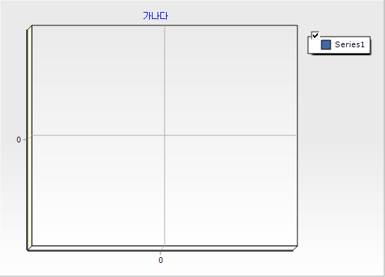

Description yeray alonso 2014-08-25 07:12:38 EDT
Created attachment 275 [details]
legend checkbox too up
The code below makes the Legend checkbox to be drawn some pixels up to the position where it should be.
uses VCLTee.Series;
  Chart1.Title.Text.Clear;
  Chart1.Title.Text.Add('가나다');
  Chart1.AddSeries(TLineSeries);
  Chart1.Legend.CheckBoxes:=true;
See the image attached

Comment 5 yeray alonso 2014-09-29 04:09:48 EDT
The only workaround I can think on is using an Annotation Tool instead of the regular Title.

We had mistakenly assumed that the Annotation Tool would be known to you. Here is a code sample that shows how you can use it in this case:
uses Series, TeeTools;
  with Chart1.Tools.Add(TAnnotationTool) as TAnnotationTool do
    Text:=Chart1.Title.Text.Text;
    Left:=Round((Chart1.Width / 2) - (Chart1.Canvas.TextWidth(Text) / 2));
    Top:=10;
  Chart1.Title.Visible:=False;
  Chart1.MarginTop:=15;
