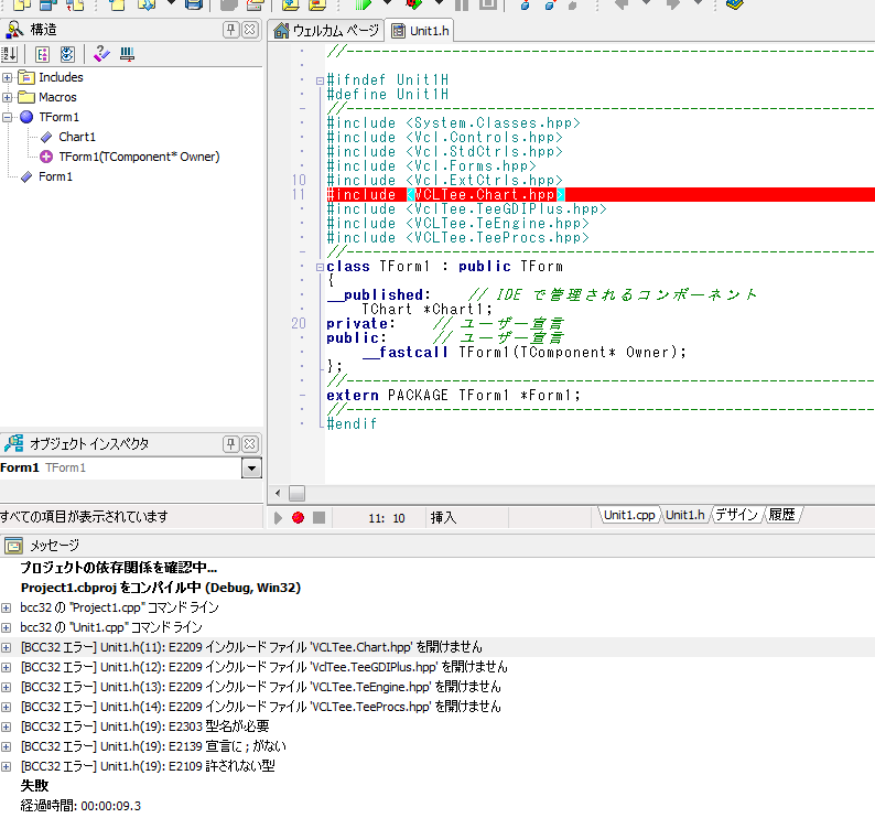

Build error occurs with TeeChart VCL v2014 in C++Builder. What we did was just launching C++Builder, placing a TChart component on a form and running it.
That's all.
The results of its execution are as follows:
C++Builder 2007 OK
C++Builder 2009 NG <- build error occurred.
C++Builder 2010 OK
C++Builder XE   OK
C++Builder XE2  NG <- build error occurred.
With C++Builder 2009, we could avoid the error by saving the project, deleting "NO_STRICT" in the csproj and ran it again.
However, with C++Builder XE2, "NO_STRICT" line doesn't exist, so we couldn't avoid it. I attached the error message.

Sorry, it was our setting mistake. By setting the following in C++Builder XE2, we could run it correctly:
We set the "TeeChartのDelphi16.Win32\Include" folder to include path in sample project option, and set the "TeeChartのDelphi16.Win32\Lib\Obj" folder to library path.
