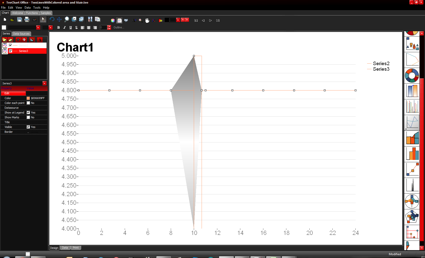

Screenshot of problem (100.90 KB, image/png)
2014-05-14 07:25 EDT, PoLabs

TSeriesBandTool doesn't calculate the points correctly when the series' stairs property is active.
uses Chart, Series, TeeSeriesBandTool;
var Chart1: TChart;
var i: Integer;
  Chart1:=TChart.Create(Self);
  Chart1.Parent:=Self;
  Chart1.Align:=alClient;
  Chart1.View3D:=false;
  for i:=0 to 1 do
    with Chart1.AddSeries(TFastLineSeries) as TFastLineSeries do
      FillSampleValues(10);
      Stairs:=true;
  with Chart1.Tools.Add(TSeriesBandTool) as TSeriesBandTool do
    Series:=Chart1[0];
    Series2:=Chart1[1];
    Brush.Gradient.Visible:=true;
Comment 2 PoLabs 2014-05-14 07:25:20 EDT
Created attachment 203 [details]
