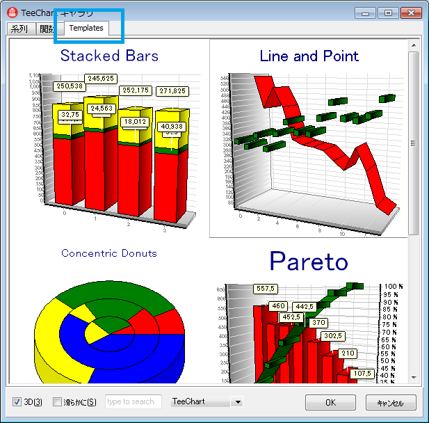

1. the Templates tab in TeeChart Gallery:
Even if setting the Japanese string for the Templates tab to TeeJapanese.pas in the SourceCode version, it's not translated to Japanese.
2. 'TRANSP=透明度';
Even if setting the above constant to TeeJapanese.pas, the added constant  disappears after compiling the SourceCode version.

Cannot reproduce.
Just tested adding "TEMPLATES=....." in TeeSpanish.pas, recompiled and it works fine.
Are you modifing the unit in the right place?
(Sources\TeeJapanese.pas instead of Sources\VCL\VCLTee.TeeJapanese.pas)
We thought "TeeMsg_" should be added as prefix because it was added in other tabs. By just adding 'TEMPLATES=テンプレート', it was displayed in Japanese correctly. Thank you.
We changed it at Sources\TeeJapanese.pas.
