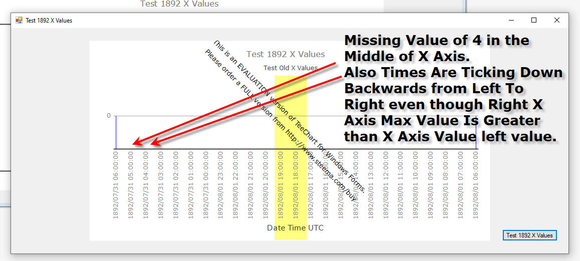

Description jzarech 2024-07-15 05:41:13 EDT
Created attachment 1070 [details]
Shows strange behaviour on chart with old dates.
When I use old dates on a chart system that works fine with newer date the chart skips any values in middle and only shows values near max and min x date values.
It also shows decreasing dates while moving from older dates to newer dates on X Bottom Axis.
Comment 1 jzarech 2024-07-15 05:41:57 EDT
