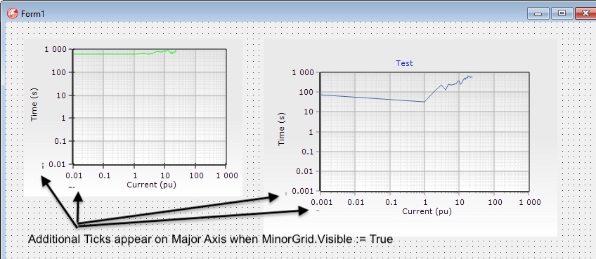

Image of issue (143.17 KB, image/jpeg)
2022-01-20 03:32 EST, Cobus

Additional Ticks appear on Major Axis when MinorGrid.Visible := True and the required min/max for axis.
This can be repeated at design time as well.
TeeChart Pro with Source.
IDE: Delphi XE4, as well as Delphi 11.
OS: Windows Pro x64 Version 10 and 11.
Issue repeatable with VCL and FMX.
Quick Code reference:
Chart1.Align := alNone;
LeftAxis.Title.Caption := ‘Time (s)’;
LeftAxis.Logarithmic := True;
LeftAxis.LogarithmicBase := 10;
LeftAxis.Automatic := False;
LeftAxis.AutomaticMinimum := False;
LeftAxis.AutomaticMaximum := False;
LeftAxis.Maximum := 1000;
LeftAxis.Minimum := 0.01;
LeftAxis.MinorTickCount := 8;
LeftAxis.MinorGrid.Visible := True;
BottomAxis.Title.Caption := ‘Current (pu)’;
BottomAxis.Logarithmic := True;
BottomAxis.LogarithmicBase := 10;
BottomAxis.Automatic := False;
BottomAxis.AutomaticMinimum := False;
BottomAxis.AutomaticMaximum := False;
BottomAxis.Maximum := 1000;
BottomAxis.Minimum := 0.01;
BottomAxis.MinorTickCount := 8;
BottomAxis.MinorGrid.Visible := True;

Created attachment 995 [details]
Image of issue
