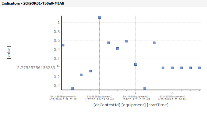

Description Mohammad 2019-02-17 04:23:35 EST
Created attachment 887 [details]
Left  Axes increment issue
We found out that in some cases the increment of labels on y-axis is not correct. In the attached snapshot, you notice that increment is 0.2 except for one value where it becomes 2.775557e-16 instead of 0!
This makes the charts very ugly and consumes lots of space.
We are using version 4.1.2018.5043 on Windows OS
Please advise if there are any workarounds for this issue.

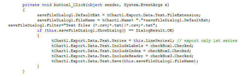

Hello!
we're going to need to be to reproduce this issue here in order to fix it or suggest a workaround for you. Possibly the easiest way to do this is to export the Chart data to a text file when you next see the issue appear - I've attached an image of the code needed to achieve this. When we have the txt file with the data that reproduces the issue you can expect a fix or a workaround to it to be produced quickly.

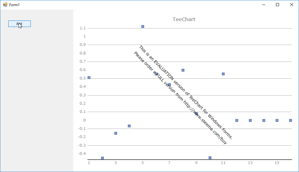

Comment 5 christopher ireland 2019-02-19 04:49:43 EST
Created attachment 891 [details]
screenshot of test project
Comment 6 christopher ireland 2019-02-19 04:51:39 EST
Created attachment 892 [details]
test project
attached a test project using the latest version of TeeChart.dll. A screenshot of the result I obtain is here -> http://bugs.teechart.net/attachment.cgi?id=891
Do you obtain the same running this project? Could you please try to reproduce your issue by modifying the above project and returning it to me?

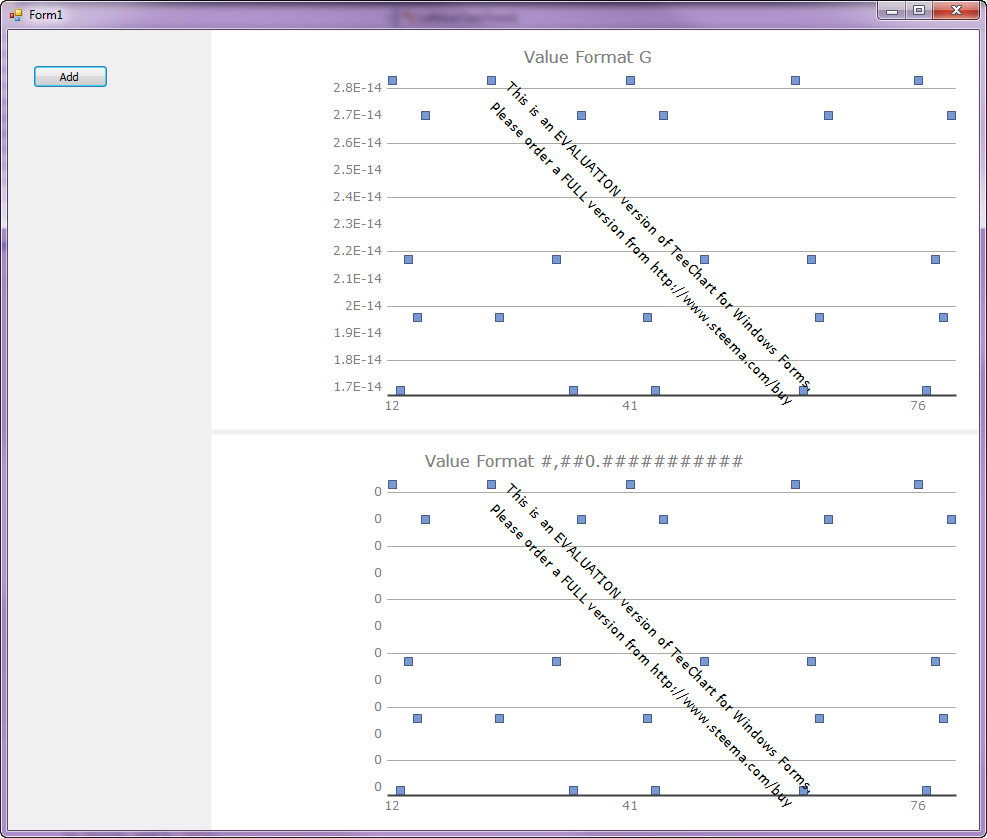

Actually this value format "#,##0.###########" not working properly with too small and too big values, please see attached snapshot.
If we used "#,##0.###########" it will get all labels as "0".

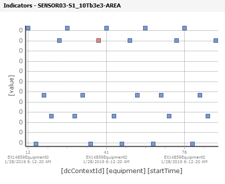

Comment 11 Mohammad 2019-02-19 09:38:36 EST
In attachment http://bugs.teechart.net/attachment.cgi?id=895 I used Value formate "G", if i used "#,##0.###########" it get all values as"0".
what I need is dynamic label values, if i used number lin 1, 2, 3, then display as it is, but if numbers is 0.00000000000000003 is will display as    3 e-17

Comment 13 Mohammad 2019-02-19 09:58:45 EST
Created attachment 896 [details]
Vlaue format "#,##0.###########"
Please see left axes when using label value formate "#,##0.###########"

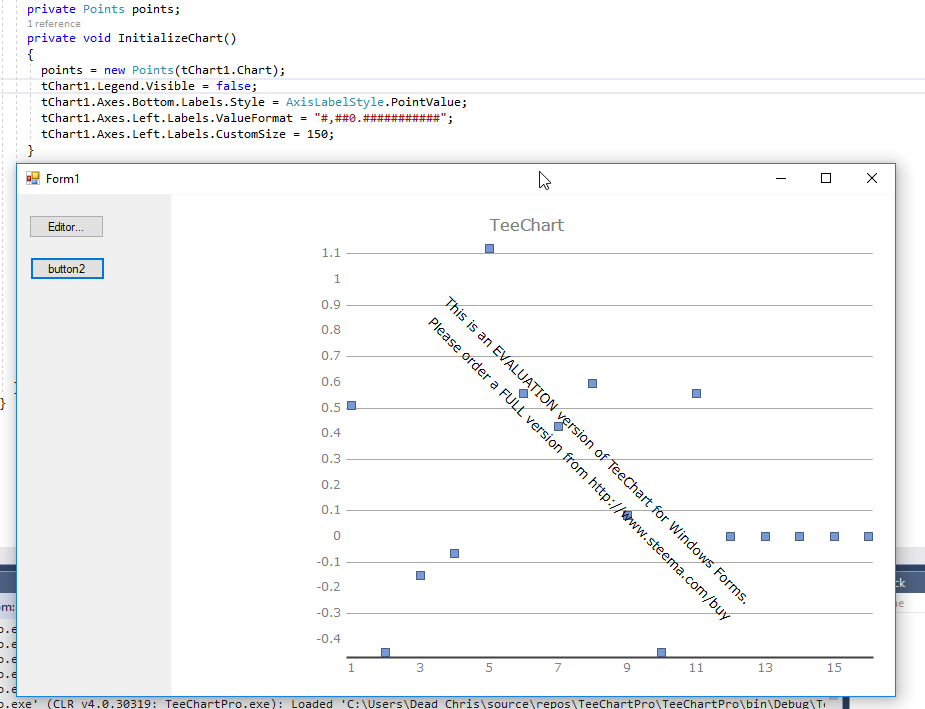

Comment 14 christopher ireland 2019-02-19 10:17:42 EST
Created attachment 897 [details]
another screenshot
Here's a screenshot of the test project using a custom number format. Could you please modify the test project so I can reproduce your issue here?

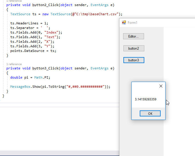

Comment 17 christopher ireland 2019-02-19 12:19:46 EST
Created attachment 900 [details]
us number format

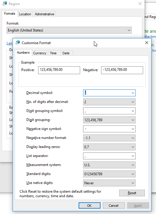

Comment 18 christopher ireland 2019-02-19 12:22:08 EST
Created attachment 901 [details]
tchart independent
We can take TChart out of the equation and have a look at the base .NET Framework functionality.
For this test I have set my number format to US, as can be seen here -> http://bugs.teechart.net/attachment.cgi?id=900
I then use the same custom number format string independently of TChart, as can be seen in the screenshot attached.
If this does not work at your end, if this also gives you a zero, then I'm afraid I don't know how I can help you.
