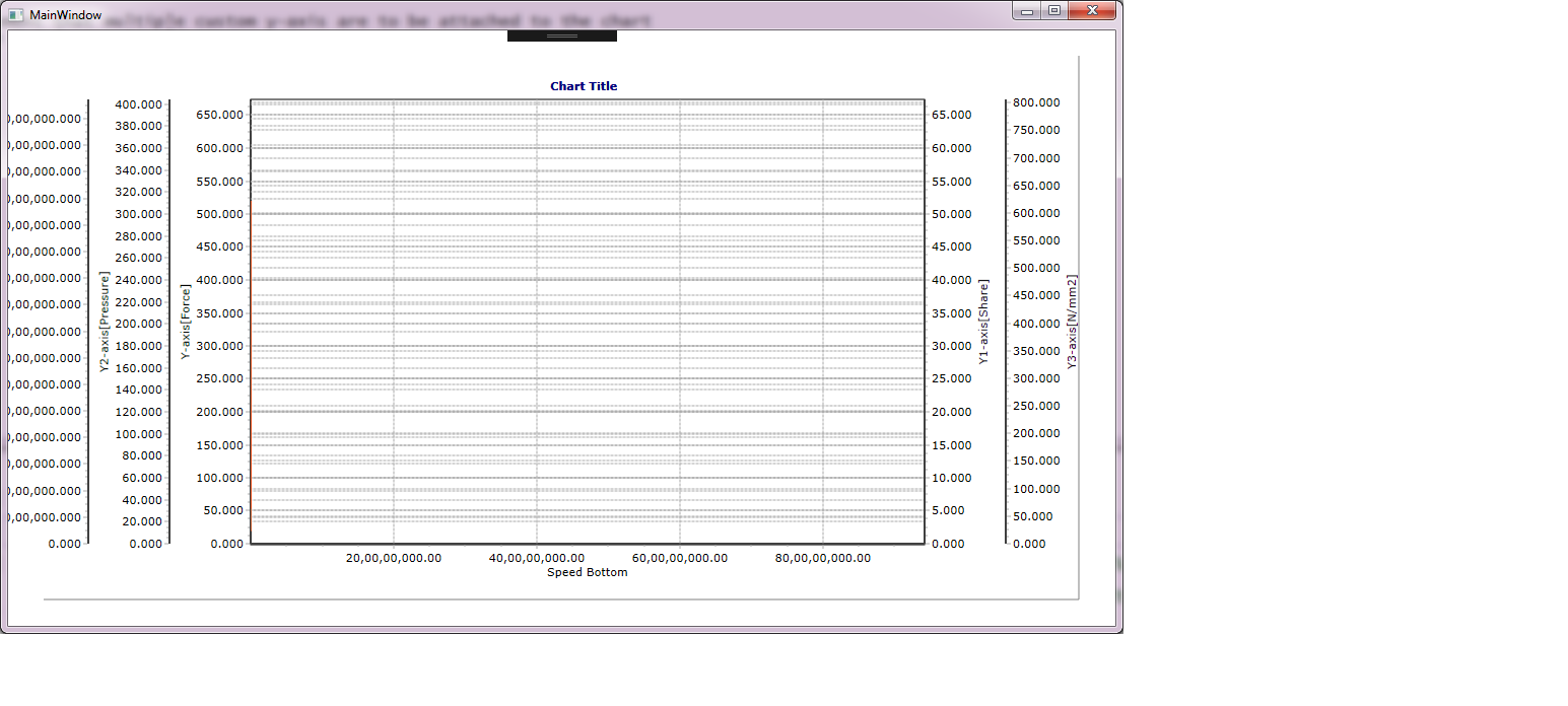

Description priyanka.shelke 2018-11-23 06:26:56 EST
Created attachment 871 [details]
Labels cut
We have a requirement that multiple custom y-axis are to be attached to the chart
The labels of the Y-axis are too large. So the labels for the last axis are not visible sometimes or cut sometimes.
I need a solution that will fit as many axis as provided in the chart along with proper label display(readable)
Please find the attachment to get the understanding of the problem area
I have gone through the forums but could not find that solution.
We would really appreciate if you provide a solution at the earliest as we are under high customer pressure to complete this issue

Comment 2 priyanka.shelke 2018-11-25 22:34:07 EST
Please find below code :

Comment 3 christopher ireland 2018-11-26 03:45:49 EST
Created attachment 872 [details]
code screenshot
this 'code screenshot' was obtained using the following code:

do you obtain the same image using the same code on your machine?
