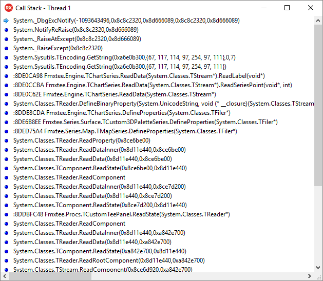

call stack (48.55 KB, image/png)
2017-09-13 06:39 EDT, yeray alonso

Created attachment 782 [details]
call stack

You get an error:
Project Project1.apk raised exception class EEncodingError with message 'No mapping for the Unicode character exists in the target multi-byte code page'.
Find a screenshot of the Call Stack attached.
