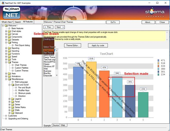

Description sandra pazos 2016-10-10 05:20:38 EDT
Created attachment 655 [details]
Zoom incorrect postion
The Zoom rectangle isn't drawn in correct position with high resolution displays where the Scaling of the screen is set to >100%.
Note set the screen resolution, e.g. 200% to check the problem.
Attached image shows the problem
