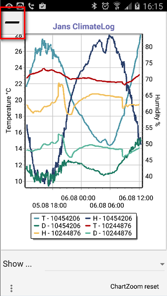

Description narcís calvet 2015-08-12 07:41:35 EDT
Created attachment 485 [details]
Loaded chart with strange element...
I use LoadChartFromFile on Android with the .tee - format.
The resulting chart contains an element which is not there/visible in the saved chart (see attachment).

Comment 1 narcís calvet 2015-08-12 07:42:09 EDT
Created attachment 486 [details]
Project reproducing the problem in Android
Comment 2 narcís calvet 2015-08-12 09:19:44 EDT
Looks like this "artifact" is a small chart, you can draw a zoom rectangle touch on the center of it and dragging the finder to the right-bottom direction.
Comment 3 narcís calvet 2015-08-12 09:53:59 EDT
This problem also occurs in iOS Simulator but not in Win32, Win64 and OSX.
