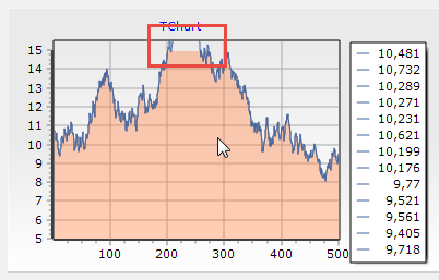

Description ChristianH 2014-12-16 04:12:47 EST
Created attachment 363 [details]
Series not respecting drawing area (seen with the correct clipped region tool area)
See the attached sample, which shows that the Region respects the given drawing area (LeftAxis starts at 5%) but the LineSeries not.

Comment 2 sandra pazos 2014-12-16 09:53:39 EST
The code below reproduces the problem:
uses TeCanvas, Series, TeeSeriesRegion;
Chart1.View3D := False;
Chart1.Color := clWhite;
Chart1.Walls.Back.Gradient.Visible := False;
Chart1.Walls.Back.Visible := False;
Chart1.AddSeries(TFastLineSeries.Create(Self));
Chart1[0].FillSampleValues(100);
Chart1.Tools.Add(TSeriesRegionTool.Create(self));
(Chart1.Tools[0] as TSeriesRegionTool).Series := Chart1[0];
(Chart1.Tools[0] as TSeriesRegionTool).Color := clRed;
(Chart1.Tools[0] as TSeriesRegionTool).Transparency := 50;
