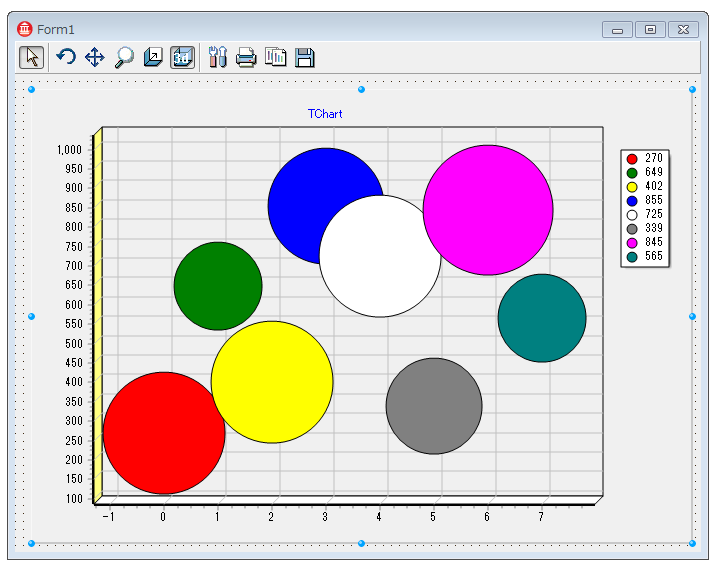

Description Shinobu Nagai 2014-11-12 23:08:29 EST
Created attachment 342 [details]
Designtime Bubble Series Points1
If a Bubble series is added from Chart Editor at design time (see DesigntimeBubbleSeriesPoints1.png) and the Visible checkbox is marked (see DesigntimeBubbleSeriesPoints2.png), the maximum value of the left axis changes from 1000 to 1050.
If the Visible checkbox is marked/unmarked several times, it gets back to 1000, and it doesn't change any more. Is this correct?
