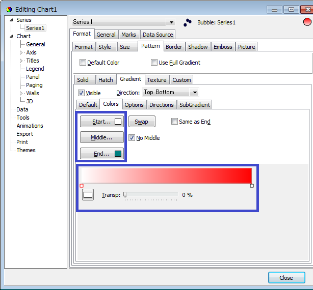

Description Shinobu Nagai 2014-11-12 19:23:24 EST
Created attachment 334 [details]
Bubble Series Format Pattern Gradient Visible1
Please follow the steps below.
1. Adds a Bubble series.
2. Opens the Series -> Format -> Pattern -> Gradient tab of the added Bubble series.
3. Marks the Visible checkbox (see BubbleSeriesFormatPatternGradientVisible1.png).

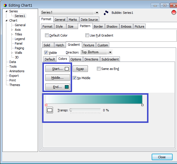

4. Unmarks the Visible checkbox and then marks it again (see BubbleSeriesFormatPatternGradientVisible2.png).

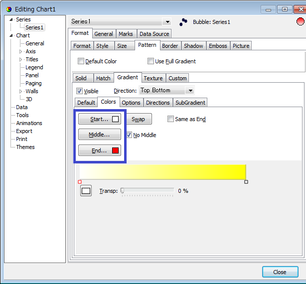

5. Iterating the steps3 and 4 several times, the gradient color changes (see BubbleSeriesFormatPatternGradientVisible3.png).
Is it correct?

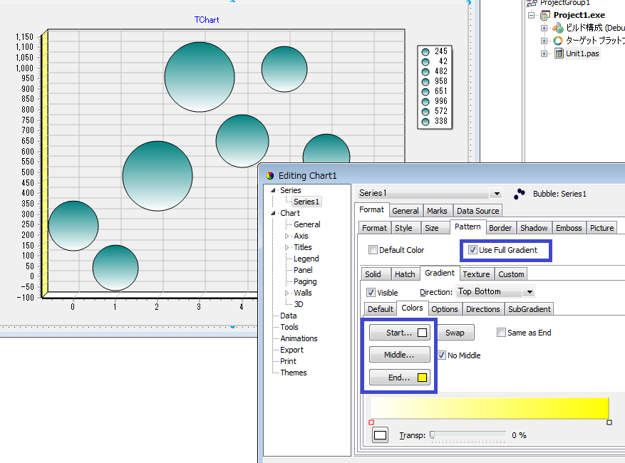

Another issue.
Please see the attached BubbleSeriesFormatPatternGradientUseFullGradient.png.
Start color is set to White, and End color is Yellow in the Colors tab.
If the "Use Full Gradient" checkbox is marked, Bubble points in the chart are displayed like green. Then, marking and unmarking the "Use Full Gradient" checkbox, End color in the Colors tab is changed from Yellow to Green.
Is it correct?
