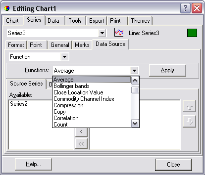

With the Chart Editor, on the First Chart page, select the Add button as if to add a new Series to the Chart. In the TeeChart Gallery choose the Functions tab to select the Function you require. Each Function is presented as a Line Series, you may change the Series Type associated with the Function later by choosing the Change button on the first Chart Page. Function definitions are easily changed afterwards on the Datasource page of the Function Series. Here, just as easily, you may change the definition of a normal Series that you have added to the Chart to that of a Function (Function is really a definition of datasource, not a definition of Series Type).
The image below shows the Datasource page when editing a Function. The Line Series (Name "Series2", Title "Average") is defined. The left listbox at the bottom of the Datasource page shows other Series in the Chart available for input (here "Series1").

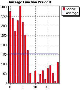

We define a Function Series with Period 0 (default) the average drawn is:
6.667

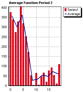

With Period set to 2 we get 3 values of average as output from the function:
5.5, 4 and 10.5
These values will plot centrally in their period range, ie. The 1st value between bars 1 and 2 of the input series, 2nd value between bars 3 and 4, etc..
You may define Period by selecting the function in the Chart Editor or you may modify Period at runtime using FunctionType.
Eg. Where Series 2 is the function series:
line1.getFunction().setPeriod(2);
Below are 2 Charts that highlight the effect of an applied Period

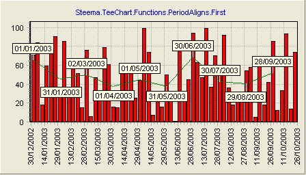

Use the Period Alignment property to align the function Points within the Series range. The following will plot the Function point at the end of a monthly Period:
	average1.setPeriodAlign(com.steema.teechart.functions.PeriodAligns.FIRST);
	average1.setPeriodStyle(com.steema.teechart.functions.PeriodStyles.RANGE);
	average1.setPeriod(com.steema.teechart.DateTime.getDaysInMonth(year,month));
Period = Month.TotalDays and PeriodAligns.First
As you can see from the picture below, the "average" is plotted at the end of the month.
