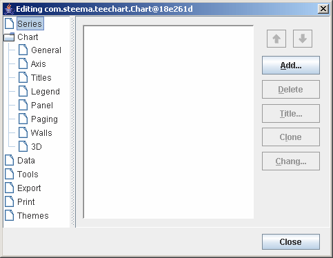

The Chart Editor
Accessing the Chart Editor at Runtime
To access the Chart Editor select a command button and place it on your Form. Double click it and add the following line of code.
ChartEditor.editChart(tChart2.getChart());
Run the project and click the button to view the Chart Editor
The Chart Editor allows you access to most of the commonly used Chart properties at runtime.
To add a new Series, mouseclick on the Add... button and select the Series type from the Series Gallery. If after selecting a Series type you wish to change it later you may do so (with a few exceptions where the Series data content may be incompatible) by returning to the first Editor screen and selecting the Change.. button.

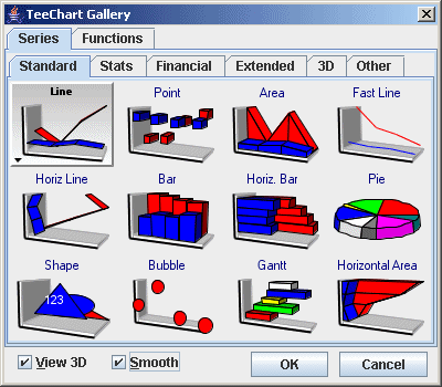

The Chart Series Gallery
TeeChart gallery
The Gallery consists of six tabbed pages:
Standard Series
Standard Series types: those likely to be called upon most frequently.
Financial
Financial Series include more specialised Financial Series types for financial applications.
Stats
Stats Series include more specialised Statistical Series types for planning or mapping applications.
Extended Series
Extended Series include more specialized Series types for Financial, planning or mapping applications.
3D
3D Series Types, those types that take three (X, Y, Z) rather than two (X, Y) variables.
Other
Miscellaneous Series types.
Select a Series type. For this exercise we will choose a Bar Series type. The Gallery will close and the new Series will be displayed in the first Chart Editor screen.
